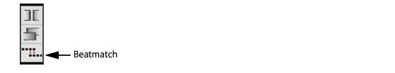

To use Beatmatching for an entire track list:
1	Click the Beatmatch button located on the toolbar.
2	Click OK to continue.
Music Disc Creator will then scan your track list, and analyze the BPM. When the scan is complete, the BPM for each track will appear in the BPM column.
