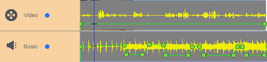

In this example, a Sensitivity setting of 10 provided the best results, lowering and raising the Music track so as not to overpower the voices on the Video track.
Note: You can adjust
Audio Ducking results manually. On the
Timeline toolbar, click the
Edit Volume Envelope for Audio Objects button
, and along the green volume line, drag, add (click the line), or remove (press delete) key frame nodes.
