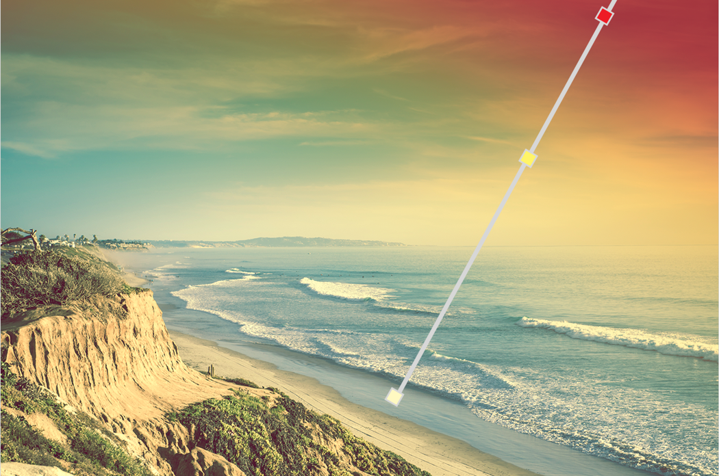

An interactive gradient fill line appears onscreen when you use the Gradient Fill tool.

2 In the image window, drag across the canvas, a selection, or an object, to set the gradient line.

To adjust the angle of the gradient, drag the rotation handle .
To add a color, drag a color swatch from the Materials palette to the gradient line.
To remove a color, drag a swatch away from the gradient line.
To change a color, click a swatch on the gradient line (a blue swatch outline indicates that it is selected), and from the Materials palette, drag a new color swatch to the selected swatch, or click the Color Picker on the Tool Options palette, and choose a color.
To adjust the transition between colors, drag the swatches along the length of the gradient line.
