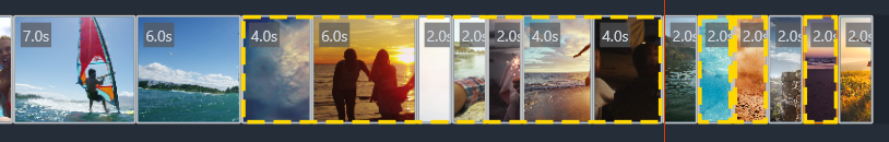

If your Movie mode is set to Manual, you can also select specific video segments and photos in the Timeline and only the selections will be exported to the final movie. Shortcut keys make it easy to perform this kind of multi-trim editing during playback.
When you select segments and photos for export (multi-trim and Pick Photo), only the selections surrounded by the dashed yellow outline are included in the exported movie.

The selected segment is outlined with a yellow dashed line.

The selected photo is outlined with a yellow dashed line.
