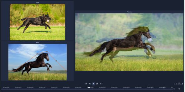

5 In the Morph Transition window, compare the orange transition guide lines in the Start and End area.
6 In the Start area and End area, drag to set the nodes for the orange guide line that will be used as a reference point.
You can add nodes by clicking the guide line.
You can delete nodes by right-clicking a node and choosing Delete or Delete All (for all but the first and last node).
7 In the Preview area, use the playback controls to preview the transition.
8 If required, adjust the guide lines to fine tune the transformation.
