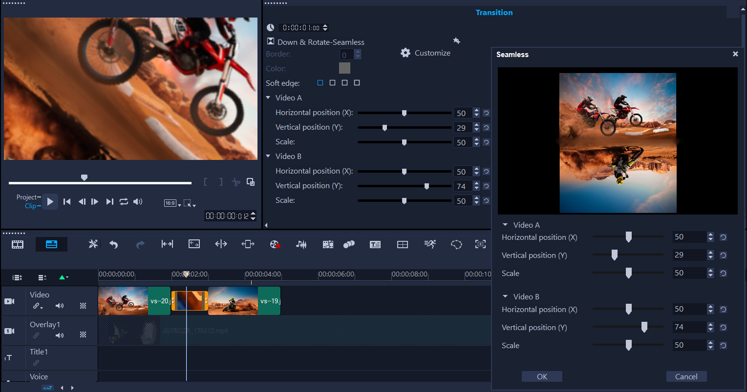

The Seamless Transition controls let you align the areas that will overlap and blend.

6 To edit the transition, double-click the transition in the Timeline to open the Options panel.
7 Adjust any of the following settings directly in the Options panel, or click Customize for a more global view of clip position and size:
Duration: Sets the overall length of time for the transition.
Soft Edge: Adjusts the softness of the edge along the transition line for the clips.
Horizontal position: Lets you align the left-right (x-axis) position of the clip.
Vertical position: Lets you align the top-bottom (y-axis) position of the clip.
Scale: Adjusts the size of your clips to create a zoom in/zoom out effect. This can also help you maximize the alignment of areas that match in each clip.
