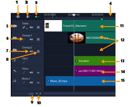

* Timeline View
Timeline View gives you the most comprehensive display of the elements in your movie project. It divides a project into separate tracks for video, overlay, title, voice, and music.
VideoStudio Timeline View
Part
Description
1 — Show All Visible Tracks
Displays all tracks in your project.
2 — Track Manager
Lets you manage the tracks visible in the Timeline.
3 — Add / Remove Chapter or Cue
Lets you set chapter or cue points in your movie.
4 — Timeline ruler
Helps you determine clip and project length by displaying the project's timecode increments in hours:minutes:seconds:frames.
5 — Track button
Shows / Hides individual tracks.
6 — Enable / Disable Ripple Editing
When enabled, clips maintain their relative positions when a clip is added to the track. For more information, see Using Ripple Editing mode.
7 — Mute/Unmute
Lets you mute or unmute the audio for the track.
8 — Track Transparency
Opens Track Transparency mode. See Track transparency.
9 — Automatically scroll Timeline
Enables or disables scrolling along the Timeline when you preview a clip that extends beyond the current view.
10 — Scroll controls
Lets you move around your project by using the left and right buttons or dragging the Scroll Bar.
11 — Video Track
Contains videos, photos, graphics, and transitions. Note that in HTML 5 mode, you can also have a Background Track.
12 — Overlay Tracks
Contains overlay clips, which can be video, photo, graphic, or color clips. Note the HTML 5 projects also have overlay tracks.
13 — Title Track
Contains title clips.
14 — Voice Track
Contains voice-over clips.
15 — Music Track
Contains music clips from audio files.
