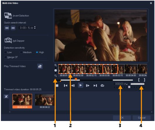

The Multi-trim Video feature is another method for breaking down a clip into multiple segments. While Split by Scene is automatically done by the program, Multi-trim Video gives you complete control over the clips you wish to extract, making it even easier to include only the scenes you want.
Part | Description |
1 — Timeline zoom | Drag up and down to sub-divide a video clip into frames per second. |
2 — AccuCut Timeline | Scan a video clip frame by frame for accurate mark-in and mark-out positions. |
3 — Playback Speed Control | Preview the clip at different playback speeds. |
4 — Jog Wheel | Use to scroll to different parts of the clip. |

Navigation controls in the Multi-trim Video dialog box |
| Reverses or advances through the video in fixed increments. By default, these buttons move up or down through the video in increments of 15 seconds. |
| Plays a preview of the final trimmed video. |
| Plays the video file. Hold [Shift] then click to play only the selected segments. |
| Moves to the start or end frame of a trimmed segment. |
| Moves to the previous/next frame in the video. |
| Repeats playback of video |
