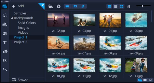

Import video clips to the Library
Let’s start with the most common situation—the shoot is done and you’ve transferred your video clips and photos from your camera to your computer. We can open VideoStudio, and jump directly to the Edit workspace and the Library.
The Library is the source for all your media, including video clips, photos, and music. It also houses templates, transitions, effects, and a variety of other media assets that you can use in your projects.
1 Click the Edit tab at the top of the application window to open the Edit workspace. The Library panel appears in the upper right corner of the application.
2 Create a folder for your project to keep all your videos together by clicking the
Add a new folder button
![](../videostudio/images/b-add-new-folder.png)
3 Type a name for the folder.
4 At the top of the
Library, click the
Import Media Files button
![](../videostudio/images/b-add-media-files.png)
, select the video clips and photos that you want to use, and click
Open.
Note that the buttons at the top of the Library can be enabled and disabled to filter the thumbnails by video, photos, and music. If you don’t see the media you expect to see, check the state of these media buttons.

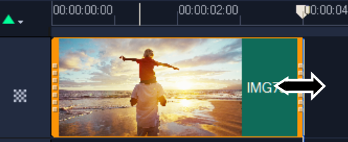

Review and trim your video clips
The key to a successful video is to keep it short enough to hold your viewer’s interest. Let’s review and trim the video clips.
1 In the Edit workspace, click a video clip in the Timeline.
2 In the Navigation area of the Player panel, click Clip, and click the Play button.
3 After you review the clip, drag the orange Trim Marker from the original starting position to the new starting position. The Scrubber moves to the selected frame and this frame displays in the Preview Window.
1. Trim Marker (one on each end). 2. Scrubber.
4 Now drag the second Trim Marker from the original end position to the new end position.
5 Click Play.
Note: Changes made to files imported into the Library do not affect the original files.
You can also trim video clips in the Timeline itself by dragging the end handles of a clip.

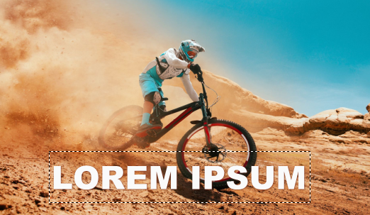

Add titles
Now let’s add a title.
1 In the Timeline, drag the Scrubber to the position you want.
2 Click the
Title button
![](../videostudio/images/b-title.png)
to the left of the
Library thumbnails.
3 You can type directly in the Preview Window, but the easiest way to get a professional-looking title, is to drag one of the title thumbnails from the Library to the Title track in the Timeline.
4 You can drag the title to any position in the Title track and adjust the duration of the title by dragging the end handles of the clip.

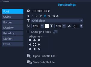

5 To edit the title text, double-click the title clip in the Timeline, in the Preview Window, select the text and type new text.
6 The Options panel displays in the Library panel. On the Text Settings page of the Options panel, use any of the controls to format your title text. For example, you can align the text and change the font, size, and color.

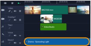

Add music
You can add songs from your computer by dragging a music file from the Library to the Music track. You can also use Auto Music to choose royalty-free music to your project.
1 On the
Timeline toolbar, click the
Auto Music button
![](../videostudio/images/b-auto-music.png)
2 In the Auto Music area that displays in the Options panel, experiment with different choices in the drop-lists and click Play selected Song to listen to the selection.
3 To add your selection to the Timeline, click Add to Timeline.
4 The music is added to the Music track, and as with other clips, you can drag it to a new position in the Timeline and trim it by dragging the end handles.
